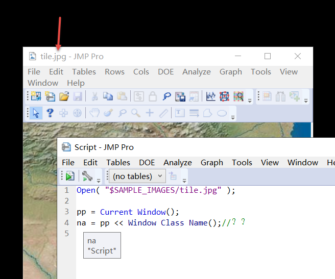

How does JSL get the file name of an image already opened with JMP?
Thanks!
//img=Open("$SAMPLE_IMAGES/tile.jpg");
pp= Current Window();
na=pp << Window Class Name();//??

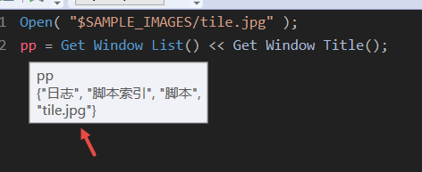

lala
Level IX
Re: How does JSL get the file name of an image already opened with JMP?
名= Get Window List() << Get Window Title();i=1;For(i=1,i<=NItems(名),i++,aa=名[i];if(right(aa,3)=="jpg"|right(aa,3)=="png",pp=left(aa,length(aa)-4);Break()));

  • I just get the picture window title like this JSL
    Open( "$SAMPLE_IMAGES/tile.jpg" );
    pp = Current Window();
    na = pp << Window Class Name();//??

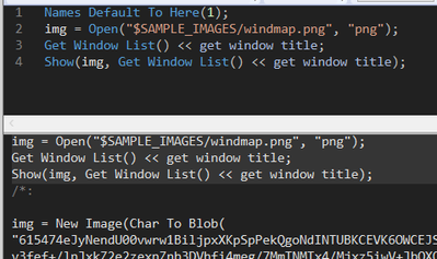

You know the name of the image if you are opening it -> get it from the filename/path. There isn't a window when you use Open() on image, it will just return the image object (at least doesn't seem to create a window in JMP17/JMP18 when run from script editor).
But you can send << Get Path to that
Names Default To Here(1);
img = Open("$SAMPLE_IMAGES/windmap.png", "png");
//Show(Get Window List() << get window title, img << Get Path);
nw = New Window(img << Get Path,
And if you have already open windows, Get Window List() << Get Window Title works but you might not know which is your image (last opened window is the last in list).
