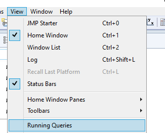

View / Running Queries -> Select query, press stop and hope for the best

Thanks Jarmo.
the menu command is already a partial solution!
