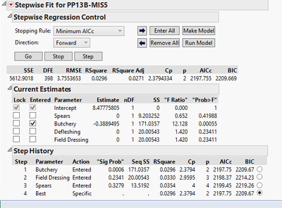

Thank you so much for your reply! I was familiar with the notion that a difference <2 suggested support for both models, but wasn't familiar with the 4-7 or >10. I wanted to show you a screen shot of what I'm talking about. In the first, JMP was able to find a "best" model using minimum AICc (the variables are an archaeological example I'm working on - using experimental tool use damage to predict prehistoric tool-use). You can see that the model with "butchery + intercept" is the best.

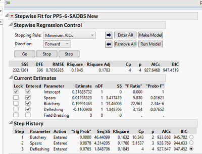

For this archaeological site, JMP did not find a "best" combination of experimental tool damage that fit the site:
I can see why it didn't find a "best" from the step history (difference <2 from previous step), but when it did find a "best" model in the prior screenshot, there was a difference <2 in the AICc of the two other model steps...I guess I'm just trying to figure out what it means when JMP finds a "best" versus when it doesn't.

I asked the tester for Stepwise about this, and she told me that it looked like you might have run into a bug that has been fixed for JMP12. If you'd like to send in your data, we could try it out with JMP12 to see if in fact you're running into that issue. Otherwise, you could wait to try it in JMP12 when it is released.

Hi Benjamin,
I just wanted to add something regarding your question about when the Stepwise procedure stops and identifies a best model, with AICc as the stopping rule. When you click Go, the automatic fits (should!) continue until a Best model is found. The Best model is the one with a minimum AICc that can be followed by as many as ten models with larger values of AICc or BIC, respectively. In other words, the stepwise procedure tries to overcome local increases in AICc for as many as ten models, before deciding to terminate.
It appears that this rule was in place for JMP 11.  So, in your example for PP13B, the smallest AICc value was for model 1.  Then models 2 and 3 were fit, but their AICc values were greater than model 1's, and so the first model was selected as best. If it had been possible, JMP would have continued fitting another eight models, and would have settled on model 1 if none of those had a smaller AICc.
By the way, I was expecting that a fourth model that included Defleshing would be fit. But that didn't happen. I wonder if Defleshing and Field Dressing might be collinear, since they have the same SS values?  (When model 3 was fit, stepwise could not fit a model 4.)
In your PP5-6 example, the model defined in Step 3 should have been identified as Best.  I wonder again if there may have been a collinearity issue, causing stepwise to be unable to fit the next model.  In any case, that third model should have been marked as Best.
