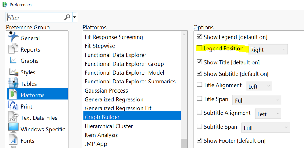

File > Preferences (or Ctrl+K) > Platforms > Graph Builder.  Its the second option at the top:

Hi @AGM,
As far as I can tell, the only preference you can set for the legend and Graph Builder is the legend position.  It would be nice to have that capability.  Might be worthwhile adding that to the wish list.

Re: How do you change graph builder default legend settings?
Hi
That would be one less thing to do, how do you do it?
I couldn't how to do it in the preferences last time I checked.
Thanks for your help, that worked for the legend position.
I'll give it a day or so, if no-one comes up with any more suggestions then I'll put you response as the answer.
