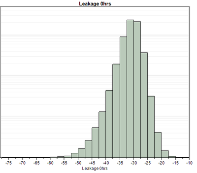

I want to be able to plot a graph to show a continous variable on the x-axis. The y-axis will not be assigned a variable. I would just like it to show the count. I am able to do this on a linear scale no problem. But when i want to show the count axis on a log scale I'm having difficulty. I cannot get the count vaules to display on the y-axis.  Can someone please help?
See below for my plot so far...

Please enlighten me, what is the logarithm of the numbers on your horizontal axis?
If the answer is the answer I expect, then there is no way to produce a logarithmic axis for negative numbers.
In addition. logarithmic axes are usually used when there are several orders of magnitude (usually several powers of 10) difference between the maximum and minimum values. Fundamentally, I see little value in creating a logarithmic axis for values where there is less than one order of magnitude from max to min.

It is not the horizontal axis i am concerned about. I'm happy with the way that is at the moment. It is the vertical axis that I'm having difficulty with. From my screenshot above you can see that i have this axis (y-axis) set to log scale. All i want to be able to see is the value of points on the axis.(e.g. 1, 100, 1000, 10000, etc). But i cannot display them.

Sorry for the misunderstanding.
You can get count axis in JMP (from the red triangle next to your variable name, select Histogram Options>Count Axis), but I don't think you can turn the count axis to logarithmic.

Yeah I saw that alright. It works perfectly for linear scale, but not log scale though. Maybe I have to create a column in my data table for the vertical axis (e.g. 1 to 100,000 or something).
