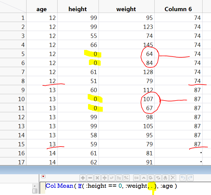

Craige_Hales
Re: How do I use an if statement and a by variable correctly in a column mean formula?
Instead of empty(), use a missing value, represented by period.
formula column using ColMeanformula column using ColMean

Craige_Hales
Craige
rperkins
Level I
Thanks Craig. This worked.
