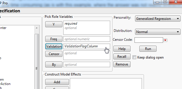

My data has a column Train (values 1,0) to split the observations into training (=1) and validation (=0) for a Lasso Logistic Regression model. However, the "Validation column" option in the dropdown of "Validation Method" in the Run form of Generalized Regression is disabled, while Generalized Regression should have support of Validation Column (see https://www.jmp.com/en_us/software/predictive-analytics-software/key-features-of-jmp-pro.html). See printscreen.
How can I use this Validation Column (interactively at first) and where can I readh more about its use. Oddly, this window does not have help describing its components; and I failed to find anything online. Thanks in advance!

Ok. In case others are stumbling over this, I figured out that validation column needs to be specified on Model Specification form in Validaiton field.
I would still love to know where how to get a descriptive help to buttons on any of the JMP window. It is common to have a [?] symbol at the top right corner of MS Windows forms, but JMP forms lack this feature. Plowing through books and web resources is not very helpful and time consuming (as is with this example, where the answer was not readily available). Any insight?
The validation column must be indicated in advance on Model Specificaiton form. Place it to Validation input box.

JMP has a number of ways of accessing Help. Most platform launch dialogs have a Help button. You can see it in the Fit Model dialog that you've shown above. It's right next to your cursor.

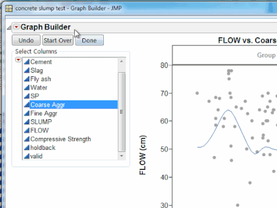

In report windows you can use the question mark tool available in the toolbar at the top of the window. (Can't see the the toolbar or menu? See the image below.)
You can also switch to the question mark tool by clicking the question mark on your keyboard. Click on anything in the report window with the question mark tool and you'll get help on it.

I believe that item 5 is what you were looking for
