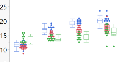

Hi,
 I've never been able to get the points to overlay the boxplts correctly in JMP. Does anyone know a way to get the points to align within each boxplot?

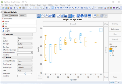

You could try adding extra column to x-axis and use that same column for color
Names Default To Here(1);
dt = open("$SAMPLE_DATA/Big Class.jmp");
gb = Graph Builder(
	Variables(X(:age), X(:sex, Position(1)), Y(:height), Color(:sex)),
	Elements(
		Box Plot(X(1), X(2), Y, Legend(3)),
		Points(X(1), X(2), Y, Legend(4))
gb = Graph Builder(
	Elements(

Choose the jittering options that suit your data. The default is usually Centered Grid, but you might want to select Random Uniform to prevent the points from aligning in rows.
