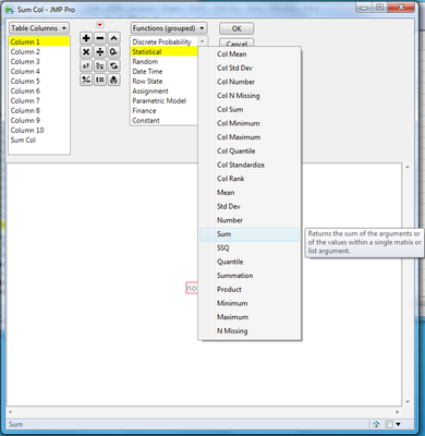

How do I sum multiple columns using the formula window?
I have a table with 100 or more columns and would like to easily sum them in another column.  Best way to do so without making a formula A + B + C.....100 times

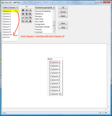

Jeff_Perkinson
Re: How do I sum multiple columns using the formula window?
You can also do this within the formula editor using the Sum() function.
Fill in the argument for the function by clicking on the first column that you want to sum, and then shift-click on the last.
