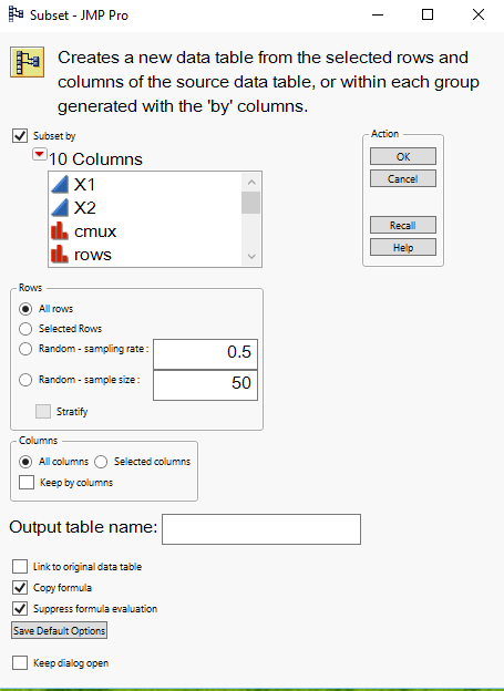

Is there a script or a function which would essentially do the opposite of the "Concatenate" function? I have a massive data file with a source column which is the primary key & other columns associated with each primary key. I am trying to split this massive data table into several smaller tables based on the primary key.
I tried it and it worked perfectly. Thanks a bunch!
I must confess I am bit embarrassed that for as long as I have been using JMP (especially the "Subset" function) I did not even notice the "By" checkbox.
