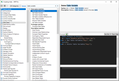

SQL is table variable not table script, so it needs different message (<< Delete Table Variable("name of variable"))
Names Default To Here(1);
dt << New Table Variable("Days", 42);
Wait(2);
dt << Delete Table Variable("Days");
