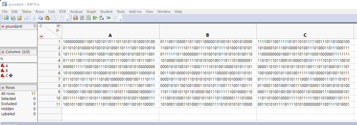

How do I perform bitwise xor operations between columns with 44-bit binary data?
I want to perform bitwise xor operations between two columns and output the result in the 3rd column. Please note that the values are 44 bits long in both columns.
Please assume as an example the values are 1s on one column and 0s on the other, 44 bits long. Can you explain how I can achieve this with a formula or a jsl script?
