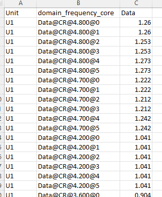

I have a raw data need to text to column with many special character, then stack them. Could you please help provide solution by JSL script for generic case. Please help to refer my excel file for detail

Hi Jim,
Look like you misunderstand my data, the code you were wrote is the output.
Kindly help to refer sheet "Raw data"
Output expected in sheet "Data after parse"
Thank you in advance.

Re: How do I parse data to column then stack them with multiple special characters
Thanks Jim a lot for your solution.
