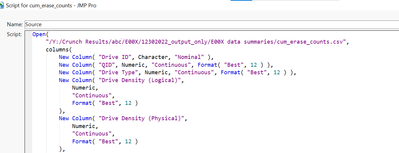

Hi All,
As I'm new user to JMP, I want to know how do I open any csv file  without specifying any folder in the JSL script.
I have saved this script from data table but instead of opening the folder and hence csv file from here I want the users to select folder and open any csv like in below image.
Thanks !

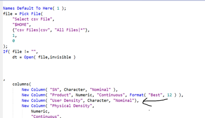

Sukanyap
Level II
Re: How do I let user select their files to open via JSL?
Hi txnelson,
Your commands helped me, but now since we're directly opening any data table it seems JMP is not reading the change in data types of the user density here arrow marked. Originally the data type of "user density" is "numeric and continuous" but in my JSL i changed it to character and nominal, but it seems JMP is not reading this, since we're opening the data table directly
 Can you please help me here, how do I make JMP possible to ready my changes, it is needed in my plotting and data processing
txnelson
It is not really to debug your issue without having your data files.  I suggest you use the Excel Wizard on the files that are not being handled correctly.  The wizard should give you some insight on how JMP is interpreting your files.
Jim
