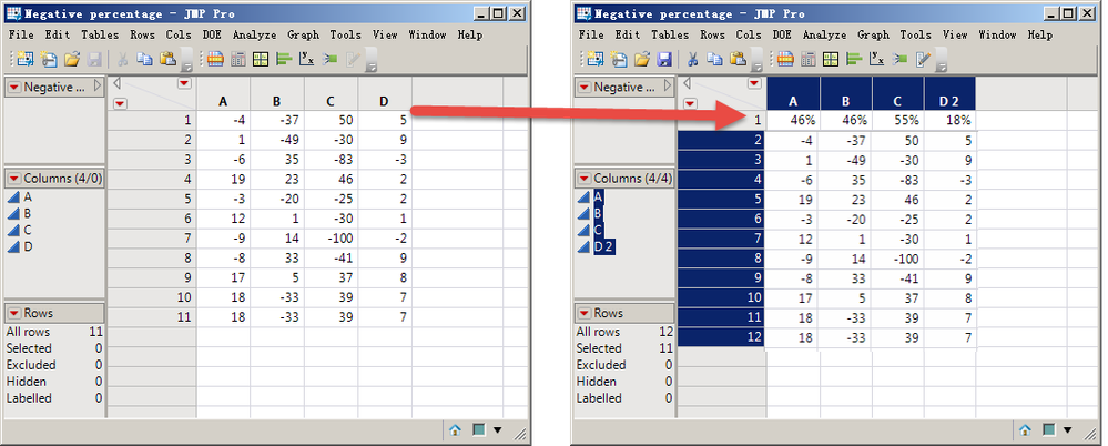

How do I insert a row at the top of the table and compute the percentage of negative Numbers for the
There are multiple rows and columns in the table. Can you insert a row above the first row and calculate the percentage of negative Numbers in the same column?The effect is shown below.

Re: How do I insert a row at the top of the table and compute the percentage of negative Numbers for
Generally, it's a bad idea to have data of different levels of granularity held in the same table. Additionally (like other statistical software) JMP requires data in a column to be of the same data type, modeling type and format.
But, so long as you don't mind a proportion rather than a percentage, if you want to do this you could use JSL:
It's done with JSL, thanks!
The new inserted row format may not be in the percentage format.
