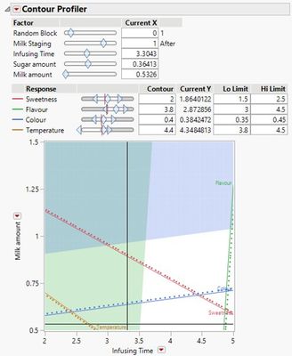

I have an example with a JMP file, attached, which I can share. This is a DOE on optimising tea. The desirability settings are:
FactorLowHigh
Sweetness1.52.5
Flavour34.5
Colour0.350.45
Temperature3.84.5

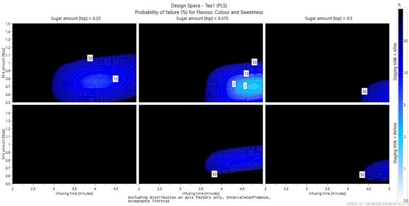

Another DOE software can make a plot like the one below. I find this graph quite compelling because you can easily tell the size of the sweet at different factor levels, which might be desirable for robustness.
I've tried to use the contour plot to visualise the space, but a limitation appears to be that I can't show how the sweet spot changes as the sugar level changes in one graph. You can easily tell how large the sweet spot area is at different factor levels. I'm optimistic that I can reproduce this graph in graph builder but I'm stuck at inputting the desirability and confidence interval into it (or maybe I need to try a different approach)
What is the best way to approach this?
