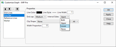

jthi
Re: How do I get upper error bars only in a X-Y plot?
Right click on the graph, select customize, find error bars and change interval sides

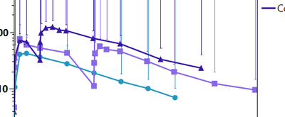

Bradley_Torres
Level III
Thanks so much! However, when trying this with "upper" option, the error bars are displaced above the mean point (like figure below) , and what I really want is to stay on the point, showing upper bar only. Do you know please how to get it? And thanks again

Bradley_Torres
Level III
Hi.  I just have time profile for different subjects , and the plots takes calculates mean and Std Dev (for each of the 3 lines) . But I just want to show the upper bar only, but when trying what you suggested me , it displaces the bar instead of keeping upper half only
