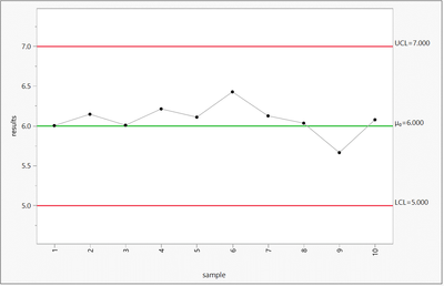

I have a control chart that I want to export to a directory specified by the user. Ideally, I would like the chart to save with no chart header, i.e., just the graphic with no text, like this:

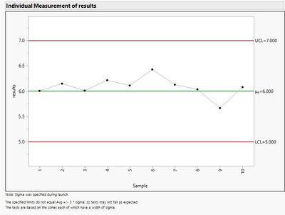

(resultsChart << Child) << Save Picture ("C:\Folder\results.jpg", JPEG );
However, this code saves the chart with a header and footer, which I don't want:

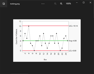

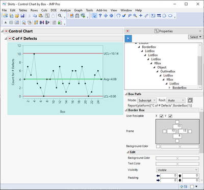

jthi
Super User
Re: How do I export a chart WITHOUT the chart header?
I usually use Show Properties to find which object to target
Names Default To Here(1);
dt = Open("$SAMPLE_DATA/Quality Control/Shirts.jmp");
obj = dt << Control Chart(
	Sample Label(:Box),
	Sample Size(:Box Size),
	KSigma(3),
	Chart Col(:"# Defects"n),
	Chart Type(C)
Report(obj)["C of # Defects",BorderBox(1)] << Save Picture("C:\temp\testimg.png", png);
Open("C:\temp\testimg.png");
If you have JMP17 it is even easier as you get Box Path
-Jarmo
