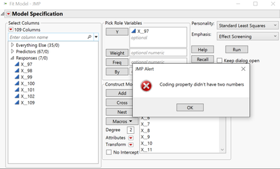

However, in the enhanced log, I notice the error "Coding property didn’t have two numbers" iterate once for each column in all_cols. I've counted.

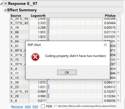

Here's where this presents a problem.  Later in my script, Standard Least Squares is performed.  Once I go to remove an effect from the list of effects in Effect Summary, an error box of the same message appears. Shown below.  If the box is exited using the "x" in the upper right corner, or if the "OK" button is pressed, this box will indefinitely appear, locking up usage of JMP until I end JMP's tasks forcefully.
