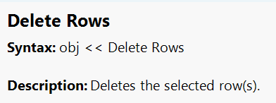

  • Delete Rows (row) **)
**) together with where(dt, is missing ...)), it's orders of magnitude faster than:
hogi_0-1754291609881.png + select where()
