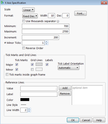

and my axis settings:
I want an increment of 200 and I want these minimum and maximum values (700 and 2700), but as you can see the x-axis labels start at 800 and go to 2600. I want them to start at 700 and end at 2700, but I still want the increment of 200. I don't see any setting that would let me achieve this.

Re: How do I customize the x-axis in Graph Builder
I would submit a request to JMP technical support.  I got the same results as you - it appears that JMP really wants to use even numbers on the axis, even if it's not what you said to start with.

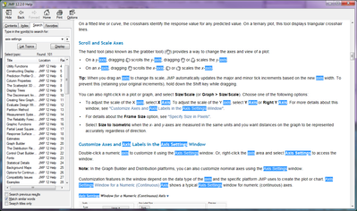

You can also interactively change the axis settings.  Here is the help page from
    Help==>Contents==>search==>After Plot and Chart
