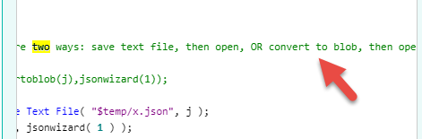

// there are two ways: save text file, then open, OR convert to blob, then open
//open(chartoblob(j),jsonwizard(1));
// or...
file = Save Text File( "$temp/x.json", j );
Open( file, jsonwizard( 1 ) );

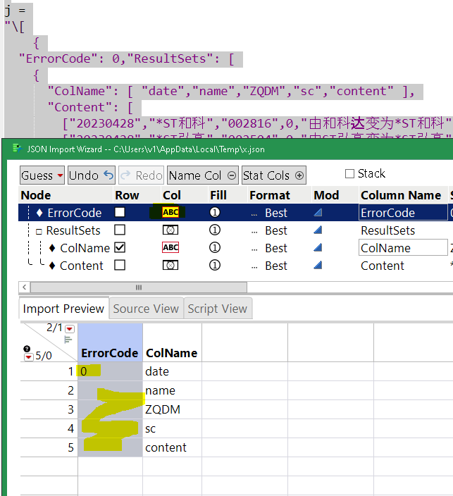

// fix up. the first 5 columns have the name, but no data
// the last 5 columns have the data but the wrong name.

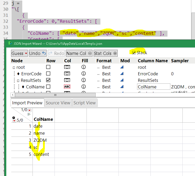

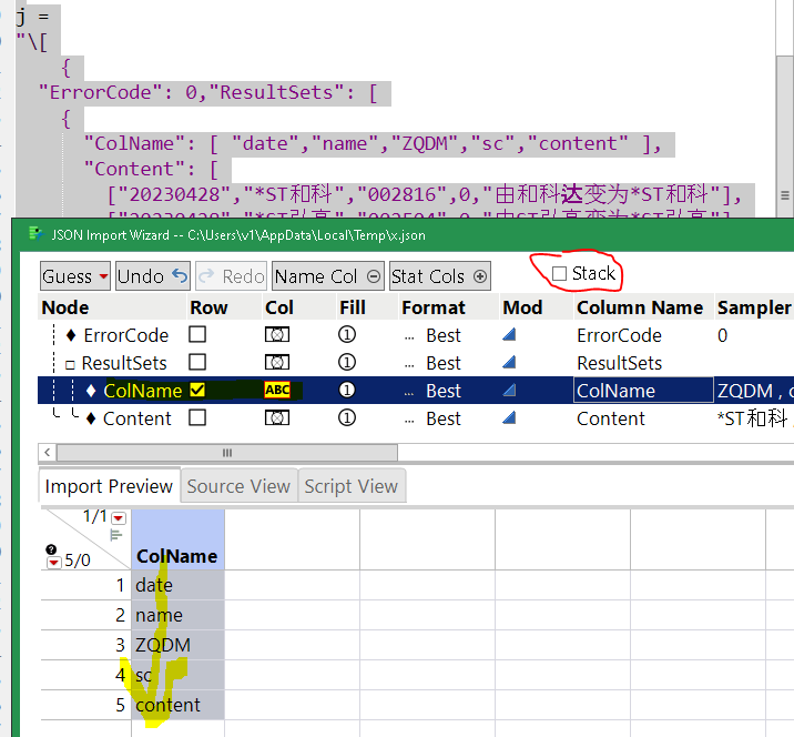

Re: How to load the JSON data into a data table with proper column name?
Stack is a boolean checkbox in the GUI, 0 is unchecked, 1 is checked. Sometimes the data is organized in a way that it is better checked, or maybe better unchecked. With your data:
stack(0) the data goes acrossstack(0) the data goes across
stack(1) the data goes downstack(1) the data goes down
In this example, ResultSet is the key selected to generate rows. That means each time a ResultSet key is closed, row(s) will be generated. In this example there is only one ResultSet key, so there is only one time when it closes.  ColName is the key chosen to make columns. The five values will all be in the same cell of a single row for stack(0). For stack(1), multiple rows are generated each time the ResultSet key is closed. If there are multiple stackable columns with stack(1), their values are emitted in parallel when the ResultSet key is closed.
If there are several columns with the same number of values, stack(1) is very useful. If there is only one column, and you do it like this, stack makes no difference:
Using ColName to create the rows and the columnUsing ColName to create the rows and the column
The ColName now generates a row for each new value it finds.
