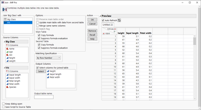

Re: How do I create a new table using another columns?(get columns from different tables)
Join is most likely the best option (match by row number if you don't have any column to use).
Then delete extra rows you don't need
-Jarmo
