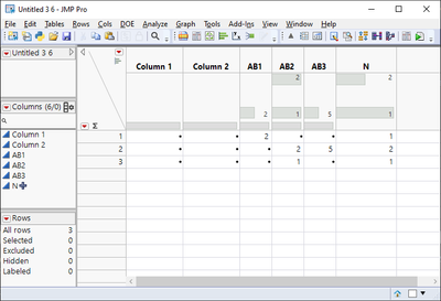

You can use formula for that (it might be a bit finicky), but generally I would use scripting. Below is one example
Names Default To Here(1);
dt = New Table("Untitled 3",
	Add Rows(3),
	Compress File When Saved(1),
	New Column("Column 1", Numeric, "Continuous", Format("Best", 12), Set Values([., ., .])),
	New Column("Column 2", Numeric, "Continuous", Format("Best", 12), Set Values([., ., .])),
	New Column("AB1", Numeric, "Continuous", Format("Best", 12), Set Values([2, ., .])),
	New Column("AB2", Numeric, "Continuous", Format("Best", 12), Set Values([., 2, 1])),
	New Column("AB3", Numeric, "Continuous", Format("Best", 12), Set Values([., 5, .]))
dt << New Column("N", Numeric, Continuous);
cols_of_interest = Filter Each({colname}, dt << Get Column Names("String"),
	Starts With(colname, "AB");
For Each Row(Current Data Table(),
	:N = Sum(!Is Missing(dt[Row(), cols_of_interest]));
and if you really want to use formula you might be able to use something like this
As Constant(cols_of_interest = Filter Each({colname}, Current Data Table() << Get Column Names("String"),
You have to figure your own comparison to filter down to columns of interest (Starts With should work for your data also)
