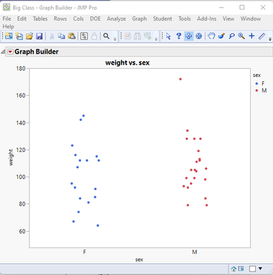

Using JMP 17, I created a simple Graph Builder Chart that includes a Legend

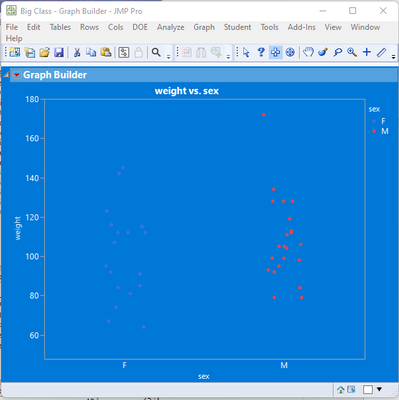

I then selected the Selection Tool
and then clicked on the Graph Builder Outline Box to select the graph
I did a CNTL/C to copy the selected area to the paste buffer.

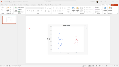

Moving to PowerPoint, I then simply pasted the graphic into a blank page
The Chart and Legend are copied to the ppt
