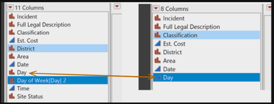

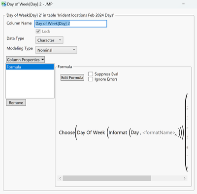

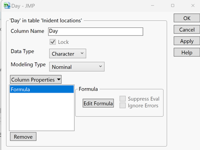

Re: How do I copy and paste a formula
Still no joy.  Here is a screen shot of the properties for the column of interest in the old data set:
This is a screen shot of the properties for the column of interest in the new data set:

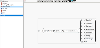

Hi,
Update the column name in the incidents table from “Day” to “Day of Week”.
The choose function is expecting the column name for its first argument to be “Day of Week” as shown in the formula editor of your screenshot.
cheers,
Stan

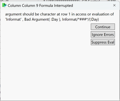

When trying to paste column properties from column 9 of the old data set to column 9 of the new data set I get the following error:
I've been using the formula in question every month this year pasting it into each new data set in the appropriate row without a problem.  However in trying to do this for the YTD incident report for the month of April 2024, nothing seems to work.  Given that knowledge of statistical analysis is limited to a couple of courses I took at UNI over 30 years ago, at best I know enough to be a useful idiot.

jthi
Informat() function only works for characters.
Just based on your visible columns I guess that in first table Day column is character (JMP won't tell it to us (still waiting for more icons to be implemented...), but it is nominal + formula works -> character column) and next one has numeric column (we can see it is continuous -> numeric).
If this isn't the case, then we will most likely need some sort of small example of your datasets like @stan_koprowski said.
-Jarmo
