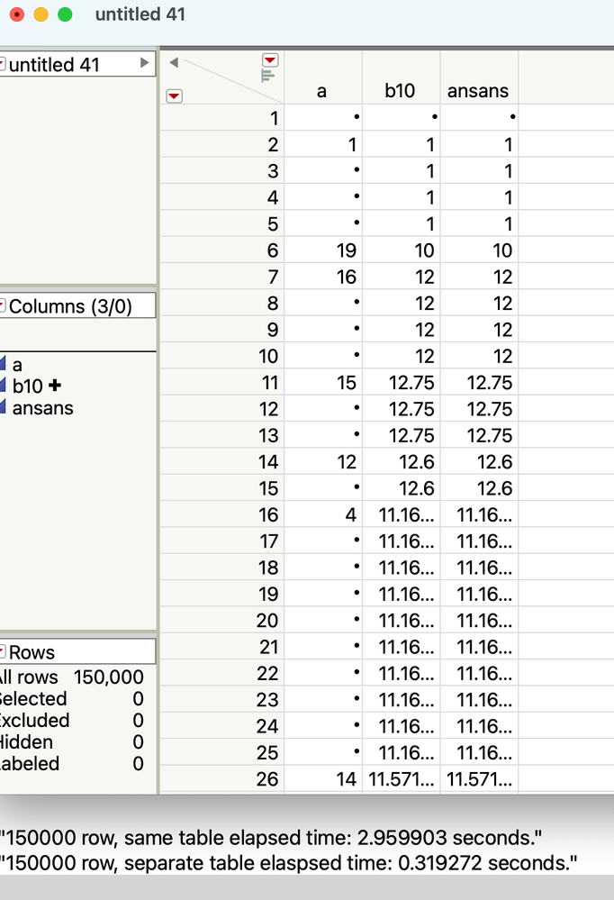

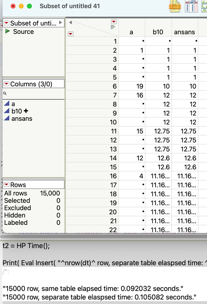

When the original table is small (like yours... about 15K rows), the two approaches perform similarly--the first is a touch faster:
As the original table grows, the "separate table" approach seems to scale appreciably better. Here is a 150K row example:
A possible deal-breaker (??) is that this approach does not produce a formula in the source table, so you would need to re-run this whenever new data is appended.
I've attached the 150K row file in case you want to experiment.

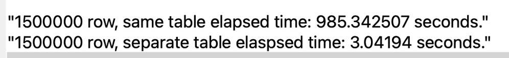

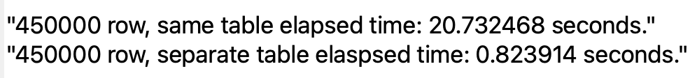

Re: How do I construct a column A, whose entries are equal to the mean/median/mode of the last 10 non-null entries of another column B?
Here are some more results. The "separate" method seems to be scaling linearly. The "same table" method seems to hit a wall somewhere north of 450,000 rows. I'm not sure why.
