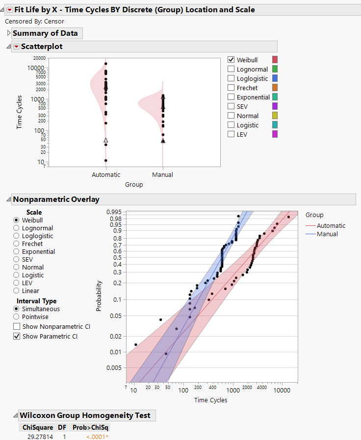

This sounds like a Reliability scenario to me. My approach would be to first use the Reliability...Life Distribution platform to understand the distribution of in insect curves, then use the Fit Life by X platform (specifying the distribution learned earlier) to understand the effects of the different treatments. This platform also includes the Wilcoxon Group Homogeneity Test and profilers.
