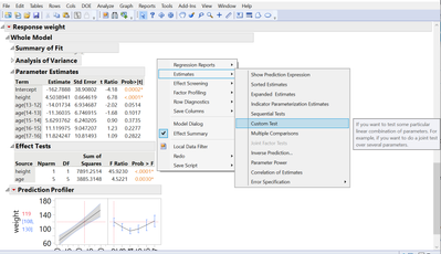

my approach to this would be to use the groups as an ordinal variable and order the categories by their LS means. Once you have that in a model, you can use custom tests to compare all sorts combination of the coefficients (differences between categories)

Yes, you want to sue a contrast. See this section of JMP Help for Fit Least Squares that you are using to get the LS Means.
