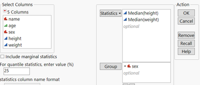

Using an example of data on students (Big Class.jmp) from JMP's sample data folder (Help > Sample Data > Examples for teaching) we can get the median Height and Weight for each group of Sex.
We select Height and Weight and choose Median from the Statistics drop down. Then add Sex to the Group role:

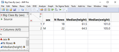

You can see the medians in the resulting summary table:
