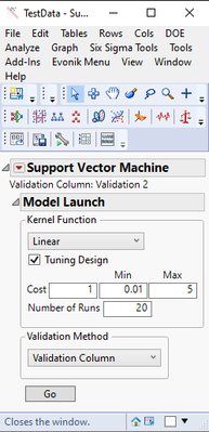

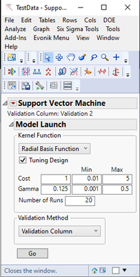

  I'm working on some JSL code where I'd like it to do something like the platform interface of the support vector machines (for those with Pro, for those without, the screen shots should help explain further).
  I'd like the panel box that contains a combo box to update and show different options based on the user selection of the combo box. With the SVM example, I'd like to do something similar: If the user selects the first combo box option, it results in an updated panel box like that shown in the first screenshot. Then, if the user selects the next option, the panel box is updated to show the new options, like the second screenshot.
