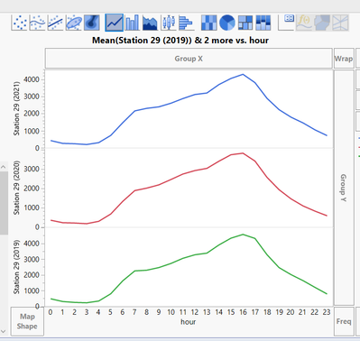

Hello there,
I tried to combine multiple plots into a single graph, I tried to use graph builder but the best I can do is 3 separate graphs, I want them to be together, for example, 3 lines in a graph just for better visual comparison. Please help out as I am stuck with my research work :\

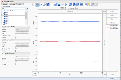

Using Semiconductor sample data as example.
Starting graph:

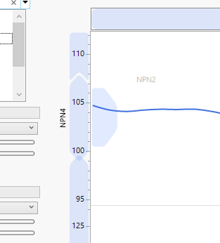

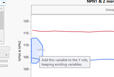

two different ways come to my mind, drag and drop NPN2 and NPN1 to area in front of NPN4:

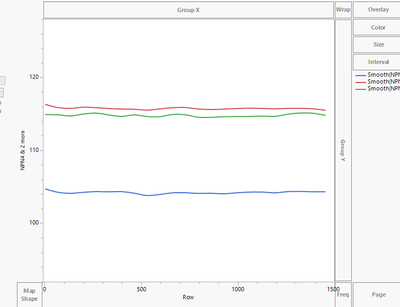

after both have been moved:

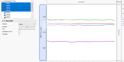

Other option. Remove all variables from Y-axis, select all variables of interest from the column list:
and drag and drop them at the same time to Y-axis:

Re: How do I combine multiple plot into a single graph
I tried changing the data type to continuous and it works, whereas it doesn't work in ordinal. Kinda weird though but thanks for your insight.
