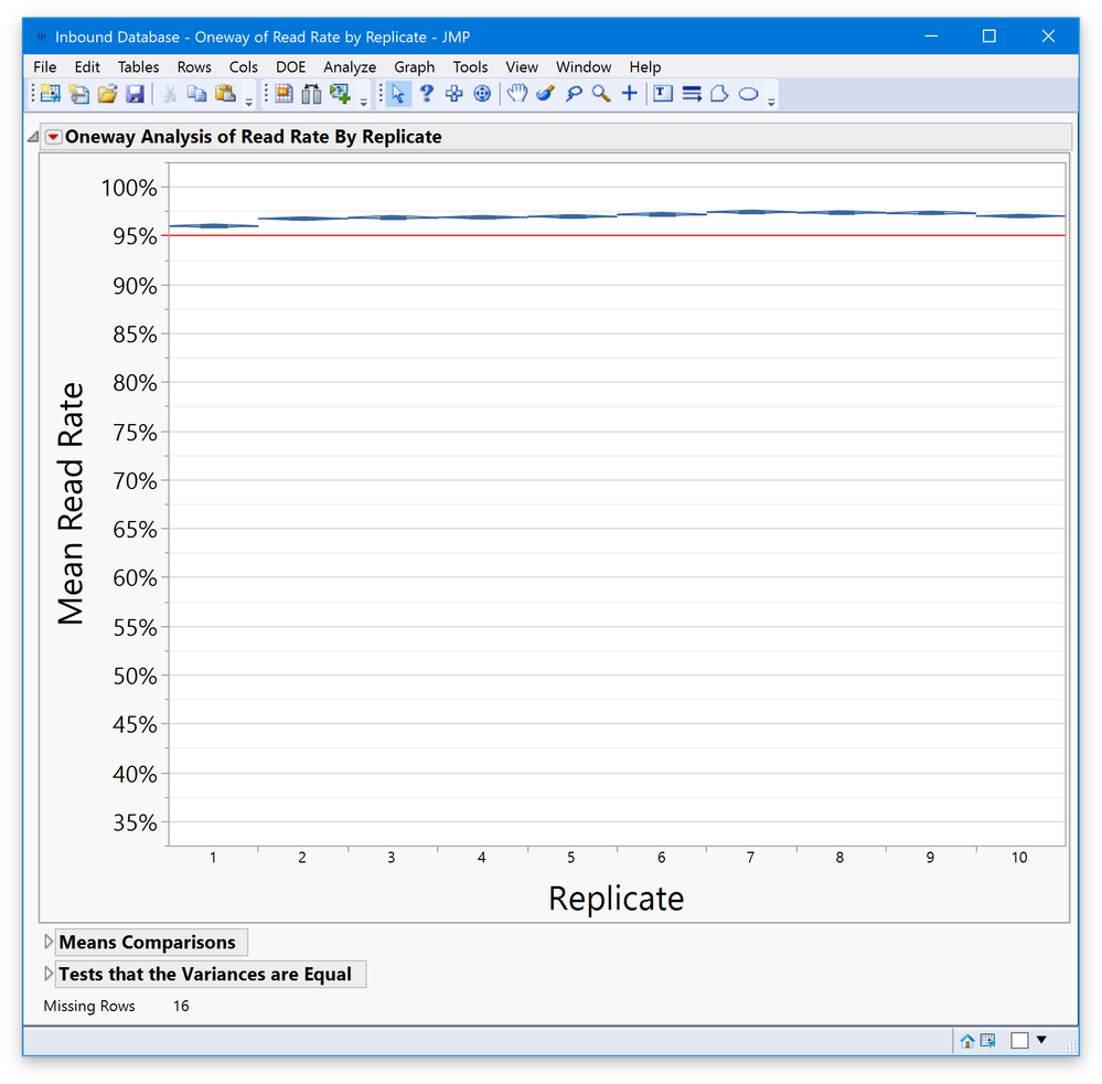

How do I change the size of the x-axis labels in the Fit Y to X (Oneway) Platform?
I have a script that generates the graph below:
While I was able to right-click onn the Y-axis to change the font size, doing the same on the X-axis only provides the following options:
  • Rotated Tick Labels
  • Tick Marks ▸
  • Lower Frame
  • Edit ▸
So there is no Axis Settings… or Font… option that will allow me to change the X-axis labels to the size I want. As I am generating these graphs from scripts, I figure I might be able to do this in JSL, but while there are some display element references that are not named and therefore make no sense, such as the script I saved to the data table from the report above:

The Dispatches for Read Rate and Oneway Plot clue me into what I am working with, but the first displatch is for display element 1. 🤦🏽‍:male_sign: The same occurs in my scripts for Graph Builder that have the very descriptive display element named 400. :face_with_rolling_eyes:
Is there a way to modify the size of the X-axis labels in the Oneway plot?

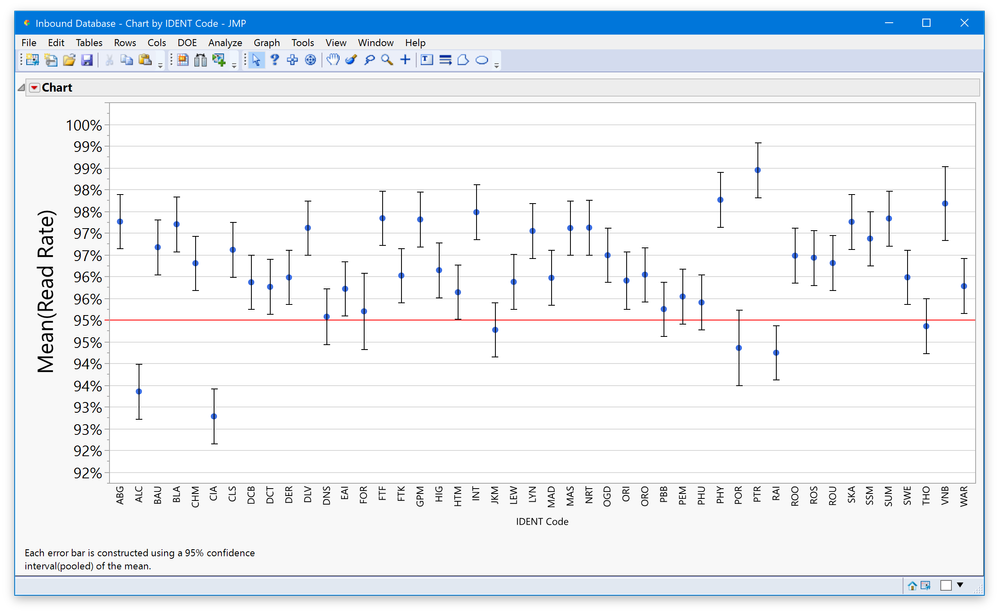

I have the same issue in the Chart platform.
Right-clicking on the x-axis and selecting Axis Settings… generates a very limited dialog box:
No settings for the axis labels or the axis title. As powerful as JMP is as a data visualization and analysis tool—which is not a surprise for SAS’ little sibling—the inconsistencies in graph settings across platforms is perplexing and often exasperating. 🤯
