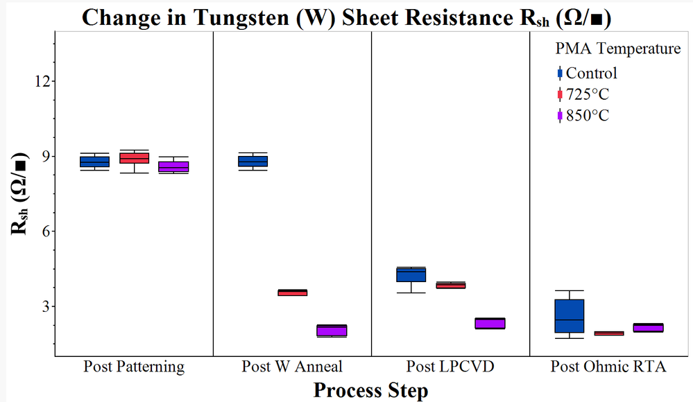

Hello! I am trying to make the top and right border on the attached graph black and size 2 to make it publication quality. I am able to toggle it on and off using Right click -> Graph -> Border though. I checked the properties as well and I am unable to see a option to change it.
Additionally, I want to put a outline around the Legend frame box if possible? Thanks!

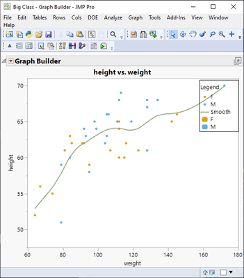

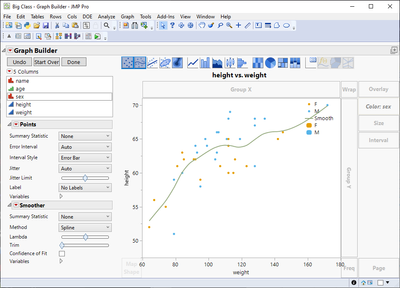

> I assume border follows same "numbering" as Border Box
I would suggest using <<Border(1) rather than <<Border(15). The general Border property works like Padding and Margin, except that currently only 1-pixel borders are currently supported. If that were to change, a setting of 15 might be a bit surprising!
You can also explicitly use <<Border(Left(1), Top(1), Right(1), Bottom(1)) to make it more clear. When a single value is used, it applies to all sides.
