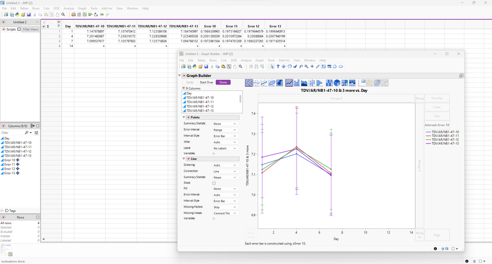

Hello,
I'm building a graph in JMP 19. I have measured a parameter (DAR) for four samples over a number of days. I also have a reportable error on my parameter which I've measure as 2.8% of the measured DAR. I'm plotting the DAR over time with a separate line per sample, so it looks like this:
My problem is that I can't manage to associate different error intervals to different lines (or series of points). The different errors are ready as columns in the data table (as you can see beyond the graph). However, only the column "Error 10" seems to be applied to all points.
If you have any suggestions I'd be really grateful to hear them! Thank you :)

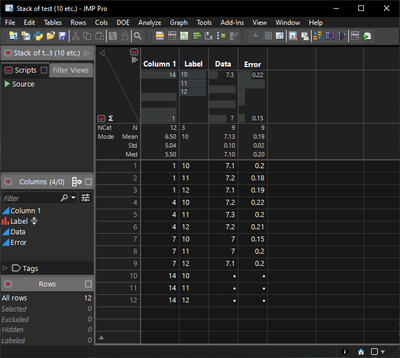

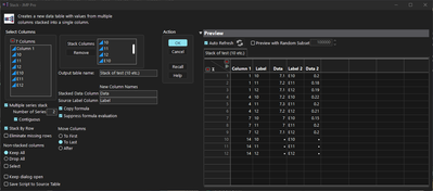

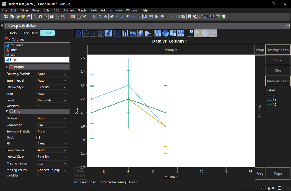

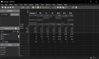

I think stacking your data might work. As no data was provided, I will use simplified example like this
Clean columns slightly

Thank you so much, it worked perfectly!
