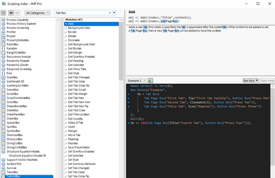

Most likely you can use << Add.
From Scripting Index:
Names Default To Here(1);
New Window("Example",
	tb = Tab Box(
		Tab Page Box("First Tab", Tip("First Tab Tooltip"), Button Box("Press One")),
		Tab Page Box("Second Tab", Closeable(1), Button Box("Press Two")),
		Tab Page Box("Third Tab", Icon("Nominal"), Button Box("Press Three"))
Wait(1);
tb << Add(Tab Page Box(Title("Fourth Tab"), Button Box("Press Four")));
