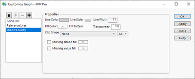

Is it possible to set a different default line width on a map shape in graph builder? Currently, every time I make a map with a referenced "map role" column in graph builder it defaults to a width of 1. To change it to the appropriate scale, I have to go to: customize graph>Shape:>line width and change it manually every time. Thanks

I found this by letting JMP first script it for me. I first modified the line width from Customize menu
and then got the script for Graph Builder to Clipboard
