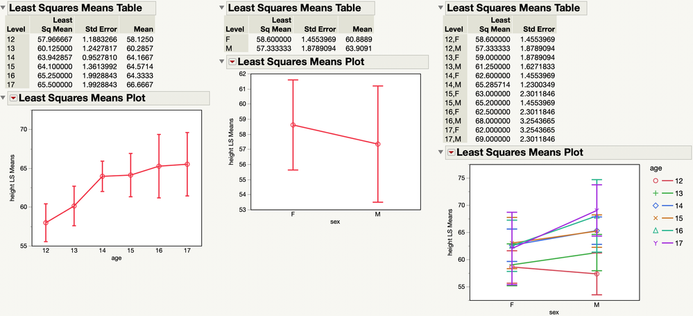

In the Fit Model platform, when I view the LSMeans plot for the effect of a single categorical factor, the plot gives confidence intervals around the LSMeans. However, in the LSMeans plot for an interaction between two categorical factors, the LSMeans are plotted without confidence intervals.
Is there any way to add confidence intervals to the LSMeans plot of the interacting factors?

Re: How do I add confidence intervals in LSMeans plot of an interaction effect?
It works for me.
I have no idea why it is not working for you. I did nothing special. I used JMP Pro 14 but I believe that the error bars require neither JMP Pro nor JMP 14.
You might contact JMP Technical Support if no one else is able to solve this problem for you here ([email protected]).
It appears to have changed with JMP 14.
In JMP Pro 13 I do not get error bars in the LS Means plot for interaction effects, but it works in Jmp Pro 14.
Also, JMP Pro 14 asks if to create an interaction plot and which variable to use as overlay. JMP 13 plots the interaction by default and picks (alphabetically it seems) an overlay variable without asking the user.
