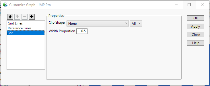

Right click on the graph and select Customize.
Go to the Bar entry and change the Width Proportion value

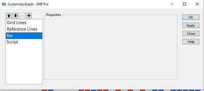

I'm not sure what happened but my jmp didnt show the same optionDanial1_0-1605807615161.png
