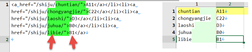

How can you do this faster with JSL?
Require these characters to be replaced with the result in the diagram
<a href="/shiju/chuntian/">A11</a></li><li><a href="/shiju/chongyangjie/">C22</a></li><li><a href="/shiju/laoshi/">D3</a></li><li><a href="/shiju/juhua/">B0</a></li><li><a href="/shiju/libie/">B1</a>
Explanation: This kind of data is very large.
I replaced slower with the following code
tx=Substitute(tx,"</a></li><li><a href=\!"/shiju/","\!N","/\!">","\!t");Set Clipboard( tx );

What you want to do faster and what do you consider fast? The substitute part takes less than 10 microseconds
Names Default To Here(1);
tx = "\[<a href="/shiju/chuntian/">A11</a></li><li><a href="/shiju/chongyangjie/">C22</a></li><li><a href="/shiju/laoshi/">D3</a></li><li><a href="/shiju/juhua/">B0</a></li><li><a href="/shiju/libie/">B1</a>]\";
s = HP Time();
Substitute(tx, "</a></li><li><a href=\!"/shiju/", "\!N", "/\!">", "\!t");
e = HP Time();
Show(e-s);

What if the number of rows after replacement reaches 100 million?
Is it faster to replace with regular?
I find that the substitutions written this way are not as fast as the regular substitutions of the text editing software EmEditor.
