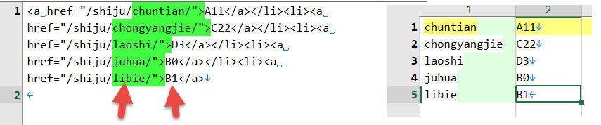

How can you do this faster with JSL?
Require these characters to be replaced with the result in the diagram
<a href="/shiju/chuntian/">A11</a></li><li><a href="/shiju/chongyangjie/">C22</a></li><li><a href="/shiju/laoshi/">D3</a></li><li><a href="/shiju/juhua/">B0</a></li><li><a href="/shiju/libie/">B1</a>
Explanation: This kind of data is very large.
I replaced slower with the following code
tx=Substitute(tx,"</a></li><li><a href=\!"/shiju/","\!N","/\!">","\!t");Set Clipboard( tx );
Thanks!
