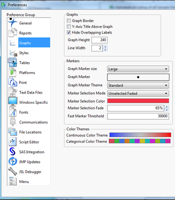

After a couple of minutes of tinkering, I found out that you can change the settings of the active or selected bin of the histogram in the Distribution Platform by going to Preferences > Graphs > Filled Areas - then select the Fill Selection Color of your choice and change the Fill Selection Mode option from Selected Patterned to Selected Same Color (link to animated gif screencast).

Hi Randy, I'm brand new to JMP. I tried following your example above but I don't have a box for "Filled Areas," which might be because I'm running JMP 11.2. I'm wondering if anyone might know how I can access the "Filled Areas" section (if it exists) for my version of JMP.
Thanks,
Robert
Jeff_Perkinson
Re: How can you change the color of one single bin of a histogram?
The preferences to change the Fill Selection Color and Mode are new in JMP 12. Check with your site administrator to get access to JMP 12.
