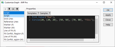

jthi
Re: Graph Builder y=x Line Not Tied to Specific Graph
It is the position of the script, so you can force the order in which they are drawn
Names Default To Here(1);
dt = open("$SAMPLE_DATA/Big Class.jmp");
gb = dt << Graph Builder(
	Variables(X(:weight), Y(:height), Overlay(:sex)),
	Elements(Points(X, Y, Legend(9)), Line Of Fit(X, Y, Legend(11)))
Report(gb)[FrameBox(1)] << Add Graphics Script(
	1,
	Fill Color("Red");
	Circle(
		20,
		{20, 20},
		{50, 50},
		{70, 80},
		"FILL"
	2,
	Circle(
		20,
		{40, 20},
		{40, 50},
		{40, 80},
		"FILL"
Like you see in customize menu
Edit: Specify the Order of Graphical Elements (jmp.com)
-Jarmo
