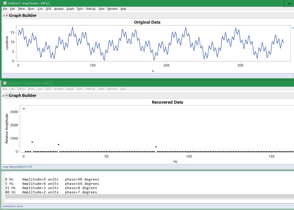

What are you hoping to recover?
  1. Frequency/Amplitude
  2. Phase
  3. DC offset
Recovering the three frequency and amplitude components (80,21,5 and 2,3,4) is easy with the FFT function, though real world data adds complications. See FFT and DTMF for an old example. Recovering the phase seems hard. My experiment below recovers (7,8,64) if the buffer length perfectly matches the wave form's period, otherwise I think the phase information may be lost. (I'm not an expert on this subject.) Recovering the individual DC offsets is impossible because they are all added together.
This JSL needs lots more testing before you put it to use!
RADIANS = Function( {x}, 2 * Pi() * x / 360 );
NSAMPLES = 360; // 360 makes the answer look perfect. Real-world data will change everything for the worse...
time = NSAMPLES/360; // number of seconds the table holds
dt = New Table( "Untitled 4",
	Add Rows( NSAMPLES ),// generate perfect, non-real world data
	New Column( "x", formula( Row()-1 ) ), // time axis, in degrees
	// not sure why you would round this to 10 places, but it was part of the question...
	// adding 7 degrees is a phase adjustment, multiplying by 2 is an amplitude adjustment
	// adding 2+3+4 at the end is the DC level of 9. You'll never get those individual values back, just the 9.
	New Column( "min", formula( Round( 2 * Sin( 80/*Hz*/ * RADIANS( :x ) + RADIANS( 7/*degrees*/ ) ), 10 ) + 2 ) ),
	New Column( "mid", formula( Round( 3 * Sin( 21/*Hz*/ * RADIANS( :x ) + RADIANS( 8/*degrees*/ ) ), 10 ) + 3 ) ),
	New Column( "max", formula( Round( 4 * Sin( 5/*Hz*/ * RADIANS( :x ) + RADIANS( 64/*degrees*/ ) ), 10 ) + 4 ) ),
	New Column( "combine", formula( min + mid + max ) )
dt << Graph Builder( Size( 1275, 240 ), Show Control Panel( 0 ), Variables( X( :x ), Y( :combine ) ), Elements( Line( X, Y, Legend( 11 ) ) ),
	SendToReport( Dispatch( {}, "graph title", TextEditBox, {Set Text( "Original Data" )} ) ) );
// there are NSAMPLES and there will be NSAMPLES bins in the FFT result.
// the first half of the bins are interesting, 1..(NSAMPLES/2), the 2nd half mirror them.
// the lowest bin, 1, will represent the DC offset
// The bins 1-(NSAMPLES/2) are equal width in frequency; the maximum frequency is
// NSAMPLES/2 full cycles in a buffer (or (NSAMPLES/2) radians per buffer)
// (you know how much time a buffer represents, so you can get back to Hz)
freq = (((1 :: (NSAMPLES / 2)) - 1) / time)`; // cycles per second for each bin
{real, complex} = FFT( {dt[0, "combine"]} );
amplitude = Sqrt( real ^ 2 + complex ^ 2 );
dt2 = As Table( freq || (amplitude[1 :: (NSAMPLES / 2)]) );
dt2 << Graph Builder(
	Size( 1456, 289 ),
	Variables( X( :Col1 ), Y( :Col2 ) ),
	Elements( Points( X, Y, Legend( 7 ) ) ),
	SendToReport(
		Dispatch( {}, "graph title", TextEditBox, {Set Text( "Recovered Data" )} ),
		Dispatch( {}, "X title", TextEditBox, {Set Text( "Hz" )} ),
		Dispatch( {}, "Y title", TextEditBox, {Set Text( "Relative Amplitude" )} )
// At this point the min/mid/max are recovered. Do you need the phase too?
// ** I'm not confident this produces a useful answer. The answer appears
// correct for the simulated data with the perfect match to the sample
// buffer, BUT if the buffer is slightly bigger or smaller, the phases
// do not seem related to the original phases. **
// I *think* it is necessary to add 90 degrees below because you are using sin
// and fft uses cos. You should study that a bit more.
// I *think* the amplitude*2 vs amplitude*1 is because half of the non-DC
// samples are thrown away. You should study that a bit more too.
For( i = 1, i <= N Rows( freq ), i += 1,
	amp = Round( If( i == 1, 1, 2 ) * amplitude[i] / NSAMPLES, 3 );
	If( amp > .7, // this will need tweaking
		Write( "\!n", freq[i], " Hz \!tAmplitude=", amp, " units \!tphase=",
			90 + Round( 360 * ATan( complex[i], real[i] ) / (2 * Pi()), 3 ), " degrees"
Open Log( 1 );
Two graphs and some output in the log.Two graphs and some output in the log.
The zero frequency bin in the FFT (element 1 in JSL) is called DC because DC means Direct Current (as opposed to Alternating Current, AC). All of the AC is in other bins. The AC signal is offset from zero by the DC level. In the log above, the 0 Hz DC bin claims to have a phase angle of 90 degrees. It doesn't mean anything.

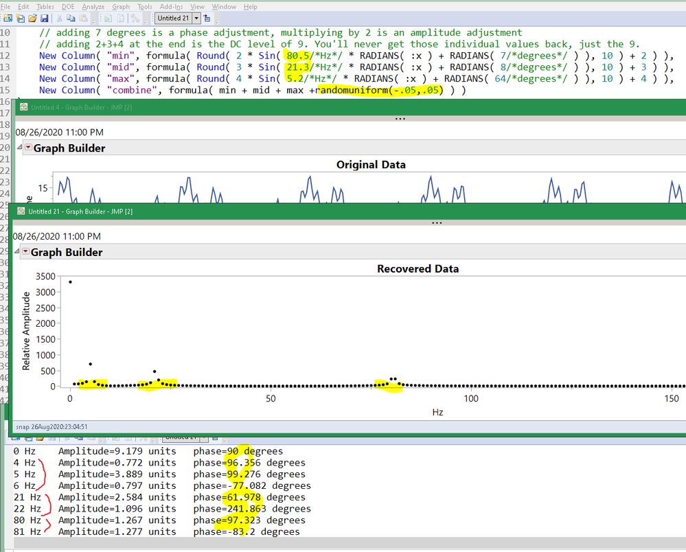

A more typical result:
When the wave form's period does not match the buffer length the results are spread across many bins and the phase is probably lost.When the wave form's period does not match the buffer length the results are spread across many bins and the phase is probably lost.
Craige
