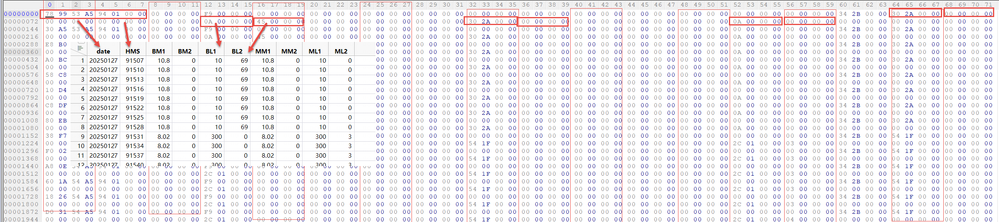

lala
Level IX
Re: How can make JSL read binary files faster?
Thank Craige!
Because the data at the beginning of the file is incomplete, I took the contents of the last line
This code is used for two splits and two blobs To Matrix
I guess so.

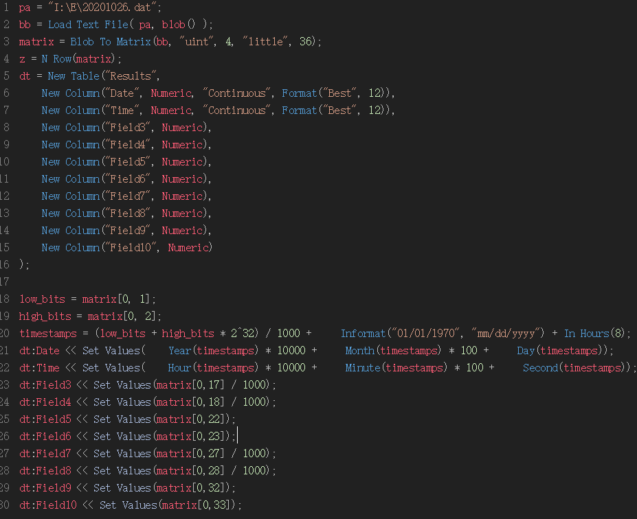

Craige_Hales
Nice! I bet it was a lot faster too! Not a single loop in JSL, all the looping is internal in C++ where it is fast.
For anyone looking and wondering:
2: reads the entire file into a blob.
3: converts the entire blob into a matrix. In particular, the matrix has 36 columns from the original binary data that had 144 bytes per line; the values are all 4-byte integers. 144/4=36.
4: z appears unused; I *think* it may be ~20 million.
5-16: makes the data table columns.
18-19: these innocent-looking statements statements are grabbing tall columns of data from the matrix.
20: attempts to make a 64-bit integer from two 32-bit integers, see comments previously about 52 bits. Again, this is an entire column in one step.
21-30: copy and transform entire columns from the matrix to the table.
This is pretty cool because there are no floating point or text values in the data. Floats could be handled with a second matrix of float 4 or 8. Text is harder but still possible; different choices depending on 7-bit, 8-bit, Unicode character sets and fixed length or variations of variable length strings.
Craige
lala
Level IX
It is much faster.
Thanks for the expert's advice.
The original 8-byte timestamp can be converted like this.
