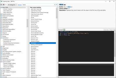

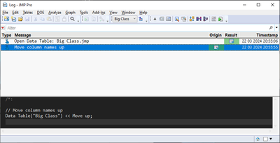

Not sure how the picture is related but if you wish to move first column to top, do it first interactively in JMP and copy the script from enhanced log (or search for the term from Scripting Index)
Usually messages you can send to objects are exactly the same you can select from menus (in this case << Move Up)

Jarmo gave you the best way how to use Jmp to do things for you: use the GUI and then
