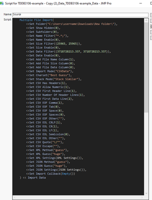

If you have all the spreadsheets in same folder you can try using Import Multiple Files which is found from Files menu. Then run it once manually to get the script from table script which will be something like this:
And if you need to you can update your script to use Pick Directory() instead of Pick File() and modify the JMP made script to work with the path you get.
