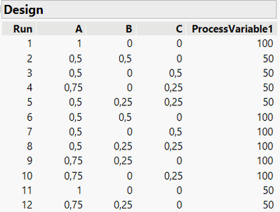

Example here by adding a continuous factor ProcessVariable1 (range between 50 and 100, datatable attached) :
And JSL script for DoE creation :

You should be able to have this similar type of design by adding any other type of factors as long as you're creating a D-Optimal design with only 2-factors interactions in the model.

Thanks @Victor_G ! This made me realise that the issue that I was having came from including power 2 effects for mixture factors, or including interactions with other factors for which I was looking for power 2 effects. I guess it makes sense that this would be the case. Removing both of those things leads the design to have the characteristics that I want.
