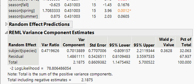

How can I send JMP 14 stats results directly to Excel via API add-in?
Is there an JMP 14 (or later) add-in that sends statistical results to an Excel worksheet?
Currently, I
Step 1.  right-click in the body of the table and choose "Make into Data Table" then
Step 2.  copy and paste the table that pops up into an Excel spreadsheet.
I'm a SAS user so I can do this in SAS but my colleague uses JMP 14 so I would like a solution for this if one exists through an add-in (or JSL).  I have searched these discussions and throughout to no avail.

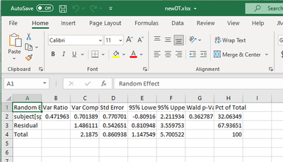

Does this little script help you in what you want.  It takes the specified table, saves it to Excel and then opens the Excel file.
Names Default To Here( 1 );
newDT = (Current Report())["REML Variance Component Estimates"][Table Box( 1 )] << make into data table( invisible );
newDT << save as( "$TEMP/newDT.xlsx" );
Close( newDT, nosave );
Web( "$TEMP/newDT.xlsx" );
Jim

Re: How can I send JMP 14 stats results directly to Excel via API add-in?
Thank you so much, txnelson!  I tried it and your solution works perfectly.  This is a thing of beauty in both its simplicity and execution.  Moreover, it takes the possibility of copy/paste error out of the equation.
