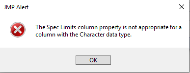

Can you help me on this.. it is working fine using V13 but when I upgrade to V15 still prompt an error in setting specs limits.
btw, function of this is to merge 2 or more csv file using 3rd to 5th row as specs. Thanks!

Re: value ordering - using JSL to set column properties
See attached error message.
txnelson
The column that you are trying to apply Spec Limits to is of a character data type., You need to change it to numeric.
